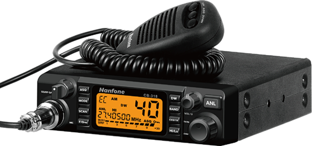

Nanfone CB-318 (Mobile/Camion)
Mode: AM / FM
Canaux: 40 (couverture total: 25-30 Mhz)
Détection automatique 12/24v
- Mode scan
Double Veilles
Programmation sur PC
Affichage multi-couleurs
Source Chine: http://www.nanfone.com/En/Pro.aspx?CateID=117
#Nanfone #CB-318
